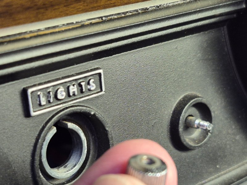

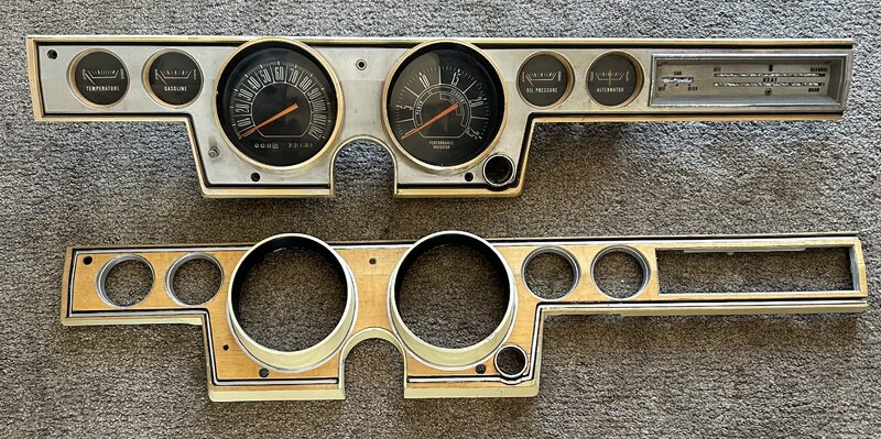

Just what the title says, how does one remove the trip mileage knob on a 1966 Barracuda speedometer bezel? I need to replace the front plastic dash on it.
They free wheel backward to prevent loss or theft. I always removed the 2 screws from back of the instrument so it leaves the housing with the bezel. Ample stem to hold in there. No need to scar the bezel.
The dash is getting transferred into the original dashboard that came with my Barracuda.
