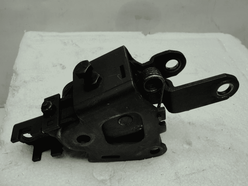

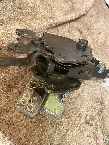

I just found one on face book I paid $150 for just the mechanism no handle no linkage. I am going to use a mopar competition plus . combine the two by tig welding the mopar arms on it to use factory linkage with a bolt on 71 or newer hantle. They are easily identified by the round spring on the bottom. This is a GM style but will be modified to the arms on the last picture
