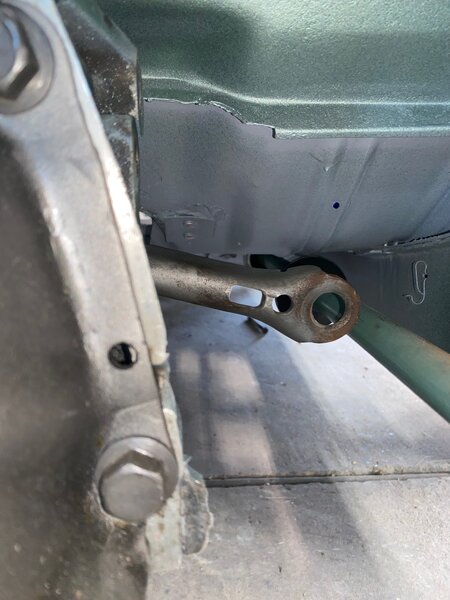

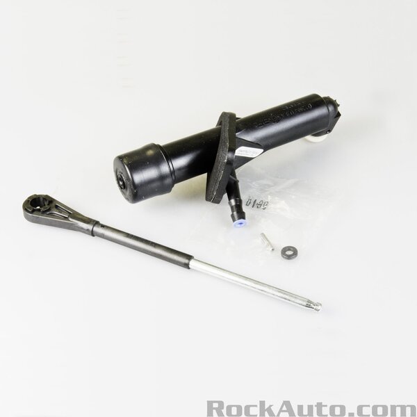

For the clutch mc, I've taking George Jets idea of using the Bronco II mc :thankyou: . It should fit in the space between the firewall and fender well, I hope it will fit. Making the connection between t he clutch "nub" and the master might be a little challenging) I have the mc coming, (dirt cheap), if it doesn't pan out, then go onto the next idea, and Jeff agrees to try it.
It would be so cool if it works! I think I've found the adapter go from the squirrelly "fitting" to threaded fitting.
Just to the right of the steering shaft is the hole where the mc should go, and there's about 4.5" of room~ that's it. But generally there's a strengthening plate that may have to go there to give strength, another 5/16 in an already tight place.

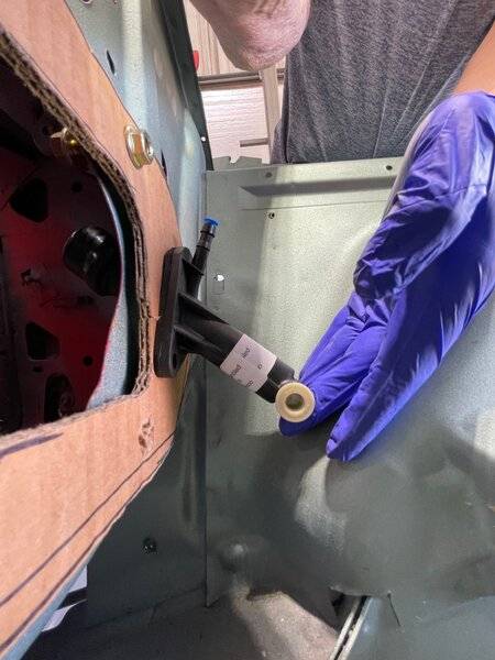

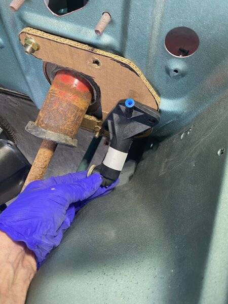

the cardboard represents the strengtheing plate and the mc will bolt to that. I'll either have to fabricate that myself or beg Red at Modern driveline to make one for me.

I need to modify the plate a little bit adding material by a tad.
I'll eventually put this on the bench to test for adequate travel. I believe the Bronco has a little more travel, I can solve this
Looking forward to your progress! You may be able to find someone local with a water jet cutter to cut the plate out for you. I don't know if it would give you any room in a place you would need it, but you can shorten that red outer steering column tube up a few inches and move the seal/ spacer up towards the firewall. Hang onto those templates....I'm more than likely gonna do a hydraulic clutch for my 65 Barracuda. Are you going to use a slave cylinder, or a hydraulic throwout bearing?
Hey JD~ the steering column "interference" is misleading~ the hydraulic line would go easily below that, but they make an 90 degree adapter to the other adapter which will put the line against the firewall. Since I have the transmission out, I'm going with the hydraulic throw out bearing. When I pass this by Red at Modern driveline, he may make the plate for me, he's always seeking to dominate the market in clutch adapters. But I don't know how he would respond to using the Bronco MC in his line up due to patent issues? I'll write him tomorrow and see what he says, but I'm still waiting for other miniscule parts. I would hope to make a decent contribution when this works out. But cudos goes to George Jets for pointing out the Bronco stuff. There could be other MC's out there that could work even better, I wouldn't know where to even begin to look~
