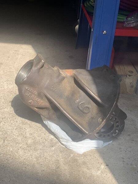

I am looking for someone to rebuild the carrier of my 8 3/4 Sure-Grip
The spider gear shafts ate into the case and wobbled out the case holes.
It will need to be welded back up and re machined.

There are times when you shouldn't talk bad about others. I have many cases I would sell very cheap to someone in need. Many times people cut off their nose to spite their face on this site. What style case do you need? That would be the first thing someone would have to know. I brought several home recently that are parts only due to sitting at the farm for so long and ring gears are rusty. Sure grip? Cone Style? clutch style?
My son also repairs anything . But it in reality would be cheaper to find a case. Welding it would weaken it unless a process is followed $$$. Plus more than likely other parts will be needed.

It is a 489 clutch style
Did not think I would find a 489 at a reasonable $ price.
Last year when I found my carrier was in such bad shape I replaced it with and after market clutch unit, that has not gone well.
I am know contemplating replacing the current carrier with a stock Sure-grip.

I know I have cone style if you look close most of these these pictured are marked cone. If I send you one I will include the races duct taped to the sides they came from. So clean it and install it. all these rears were removed over 30 years ago. So they are not wore out.

My cone 741 3.55 unit needs some help, can it be fixed or is the unit toast?
looks like that sure grip is history -- not worth the time and money to fix the case since NO internal parts ( side gears ,, spider gears ) are available anywhere -- and your parts are toast .
