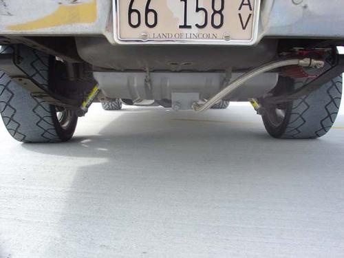

Here is what im working with as far as room goes. Might have to relocate my fuel pump.
Looks like you will, or I don't see how it could be run through there.
thats quite an uphill climb for a fuel line no? i don't know if i have seen a sump mounted that low! I imagine it's working fine if you aren't having any drain back or cavitation issues...but thats against every fuel system article i have ever seen :???:lol
The sump is supposed to be at the lowest part of the tank. It's an Aeromotive a1000, not an issue what so ever. Been on the car for 9 years.
