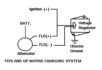

No, that is where you get the charge for the alternator, look at the diagram shown earlier...
Hemi, so for me, who I admit am slow. Then I would have a 2 wire? 1: battery 2: ground?
Battery.... it's the charge wire and only wire hence the "1 wire"

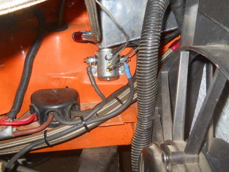

Where does the one wire on a GM?
See in the picture the one 12 inch black wire. That is all you need. It goes to a Battery bulk head in the first picture. Then I added a normally closed relay to shut the alternator off when on the start line. I use to have a short wire going to the bulk head for the battery cable. Then I put the relay in line seen in the second picture second picture
Thank you
