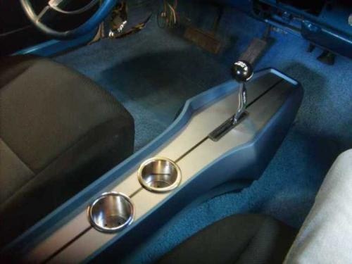

I mounted a Hurst promatic-2 shifter, inside a factory console, tossed the factory top plates for the console and made my own new top plate, complete with cup holders. Made my own console mounts cause this car was column shift originally. Also modified the collers on my steering column so that it looks like a factory floor shift car.
NICE! That's super cool!

Nice work there MileHigh.
