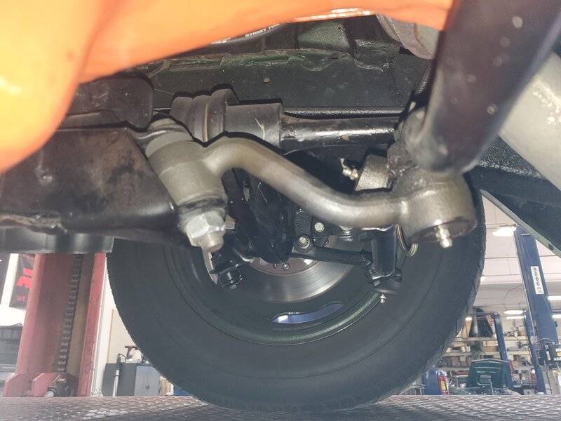

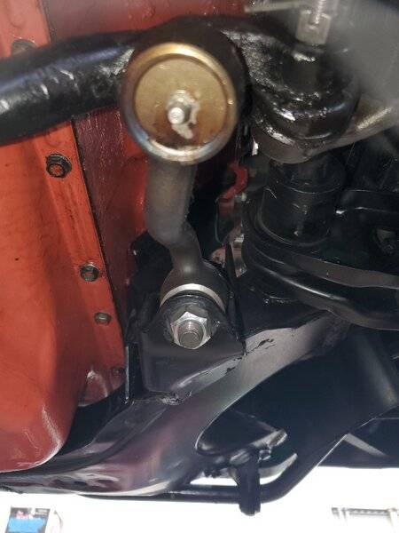

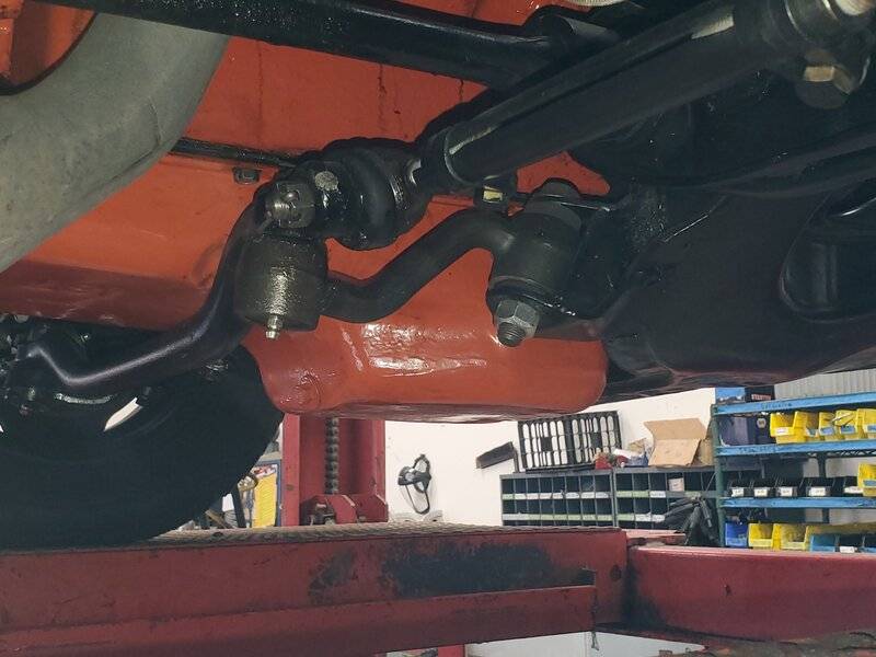

A previous shop tried to replace the loose idler arm with the recommended MOG-K7042, but it wouldn’t fit so they heated/bent a MOG-K7041 to make it fit which failed at 1000 miles. Does anyone know the proper idler arm for this car and where to get it? At this point, I have to assume the k-member mount and center link placement is correct.

I've been working with Firmfeel this week. Very helpful! He looked at the photos and told me my idler arm had been bent to fit. He has two '69 idler arms listed, one for 383 engine. I sent him an email this morning with this question. Will have to call on Monday. Firmfeel Mopar Suspension and Steering
