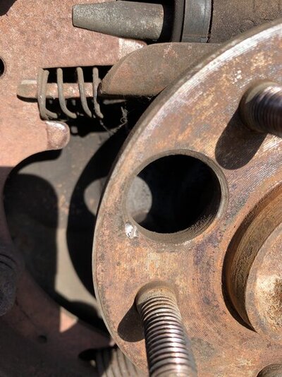

last pic is where i broke the drill bit on the hub trying to make new holes..

After market axles will work in all 3 carriers. 741 , 742 , 489. Green bearings the axles will not use bearing adjusters so the axles will have to be trimmed to fit if they are to long.
Also BBP axles when used you will need the BBp backing plates, BBp Drums, BBp park brake struts and BBp brakes,
If drilling your axles ? You need to put the fixture on the axle turn it clockwise until the lug hole in the fixture sees the large hole in the axle and mark the axle, then turn it counter clockwise until you see a lug hole in the axle and mark the axle. Move the fixture back until you are a the center of your marks. This is where you drill for the new studs. Drill and tap the axles for 1/2 20 race studs. This will leave more room for the holes to be drilled.
Remember when using your small bolt axles with BB wheels you will need to use 3/8 spacers to keep the tires from hitting the leaf springs.
You got a long way to go and being so picky about chit that don't matter is screwing you up. Buy adapters and different wheels if need be. Move on.
First you need to inspect what you have to order the correct parts. If it is a stock a body 8 3/4 it will measure 52 5/8 inches on end to end of axle housing so take your axles out and remove the drums and backing plates and measure. If it is this size, then purchased Dr diffs stock A body axles, your 3rd member should have 30 splines for the axles. you will need to upgrade the rear drums and backing plates, brakes to 10X2.5 size. you will need to choose what type of rear axle bearing you wat to use, sealed green or factory tapered, because it will matter if you need to remove the spacer between the axles in the 3rd member on the green bearings. I'm sure you will hear various other options. enjoy the car.
i highly doubt someone custom ordered axles just to fit a center section in that thing. pull an axle and see exactly what you have.
if it were me i wouldn't waste the time re-drilling small bolt axles.. grab a set of dr. diff axles and then big bolt drum brakes. i have 11X2" drums on the back of our dart. they have worked very well for many years..
First off, if it's going poorly, you're doing it wrong. This has been done and done easily for decades. You should have done research first, instead of after, then you'd be well educated on what to do. These cars aren't Chevys. They're a little different and require a different approach. I second the Dr Diff recommendation. Cass is a great guy. If anyone can help you make chicken salad out of chicken ****, he's your guy. Looks like you have a nice car. Maybe next time you tackle a project on it, you'll do your research first. It might save you a lot of trouble.
All 8 3/4” axles are 30 spline, so your reference to the 10 spline count is in the yoke, which has no bearing on your axle change. I doubt it’s a 10 spline yoke anyway on a 741 case. Changing to BBP axles is as easy as buying the axles with the correct offset to use BBP 10” brakes. What you use for bearings on the axles is up to you, I believe you can buy them with tapered bearings and use your old races, or with green bearings. Your choice. When buying the brakes, try to get a complete set from your donor source, as there are different shoe widths, and you need the corresponding backing plates for the width your are buying. You’ll get it, just take a couple shots of patience before you head back out to the garage.
