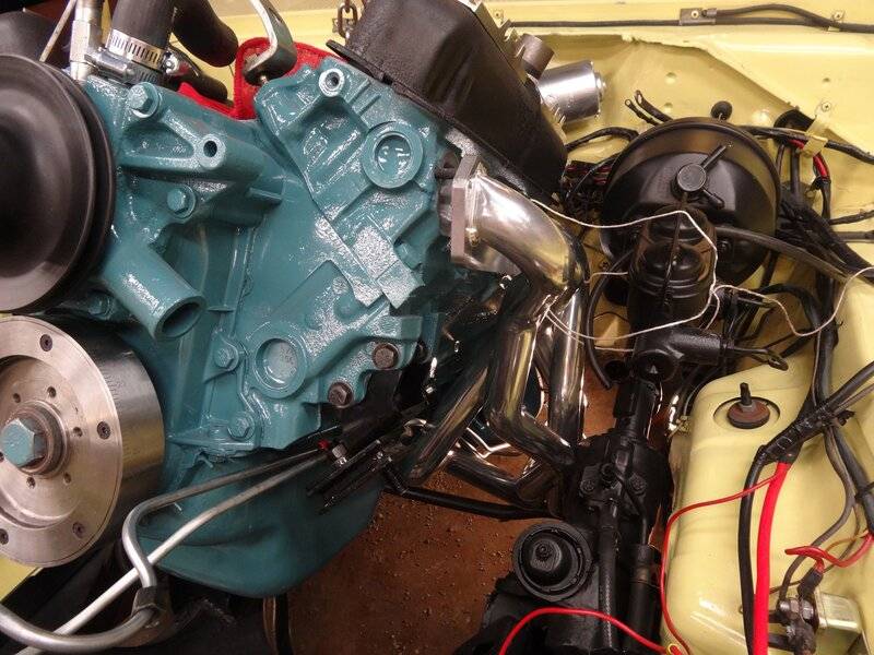

Here's how we did it dropping a 340 in a 69 Dart which is the same engine compartment as a 2nd gen Barracuda...
Hang them in the engine compartment with string or coat hangers as you can't get them in place with the engine on its mounts...

When you get most of the way in, then attach the headers on the studs in the heads for the exhaust and then drop the engine in place on the mounts...

You may not have to pull the engine, but you will need to lift it up some to get the headers in...
We were changing engines when we did that on the Dart, so we did everything at once...
