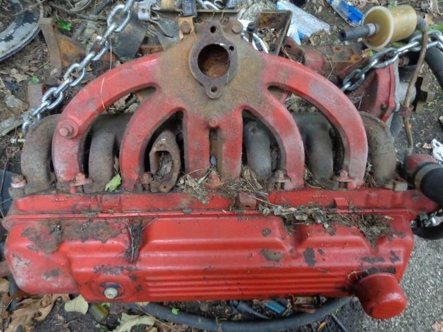

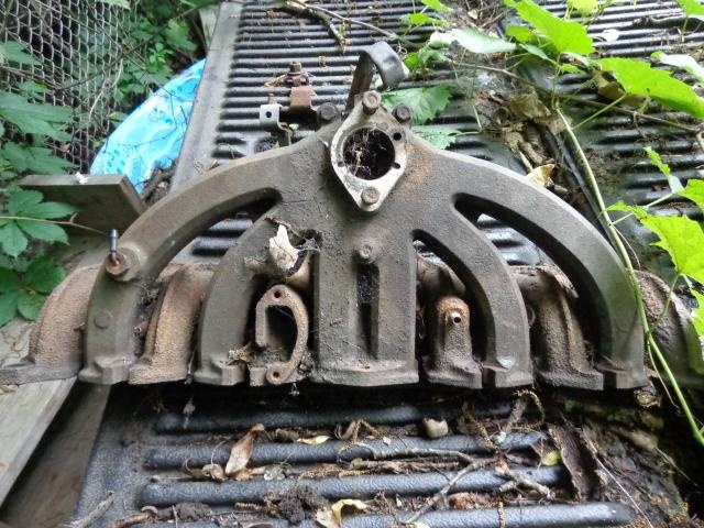

Here are two pictures of intakes. I would prefer to keep the red one as it is still on an engine that is stored outside. I believe that they are from the mid 60's, like 64, 65 ish. They both look identical. I will send the intake and exhaust manifolds without the throttle bracket. The exhaust manifolds are so you get all the screws and bolts with it, they have the typical hairline cracks. I ended up ordering a new exhaust manifold from a place brand new for less than $200.
PM me your address with zip code so I can get a shipping quote. I will send you the top one for just the cost of shipping. We like to help each other out here. I won't be able to pack and quote today, maybe tomorrow after I get an address.
Here are the pics:
Here's one on an engine, I believe a 66 model slant:
Let me know if this is what you are looking for.
