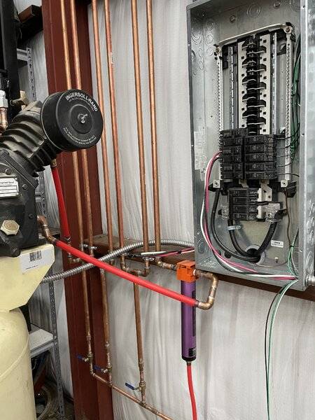

Here's my setup...
If I were to do it again the biggest change I would make is using at least 3/4" & preferably 1" piping for the condensing cooler.... The after cooler being 1/2" is fine but not good for the condensing cooler...

I run a similar style as 1wildrt
I have 4 runs up with a drain (ball valve) at the bottom of each .
I also used my old 80 gallon compressor tank as storage and cooling.
Then made another run up and down with drains.
I never see moisture now.
About once a month I crack open the drains (valves)
Once a year i drain the tanks or if I think of it in the humid summer.

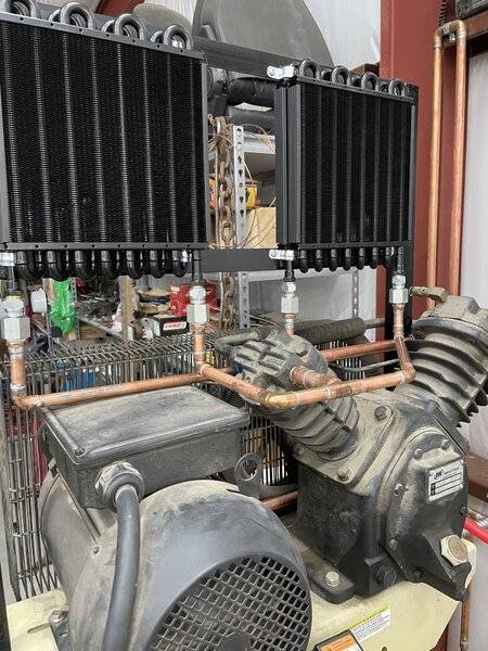

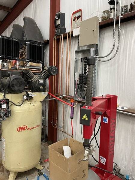

I put a radiator between the output of my 5hp two stage pump and the tank mounted on the belt guard. The fan/pulley on the pump pulls air through it. There is an automatic water drain after the radiator. The temp drop is huge from inlet to outlet and so far it seems to do it's job. I get very little moisture from the tank now. I have 50' of 3/4" copper to make a condensing cooler but I'm not sure it will make a lot of difference. We'll see this summer as I use it more. I used this video as a guide but my hardware and tube size is different.

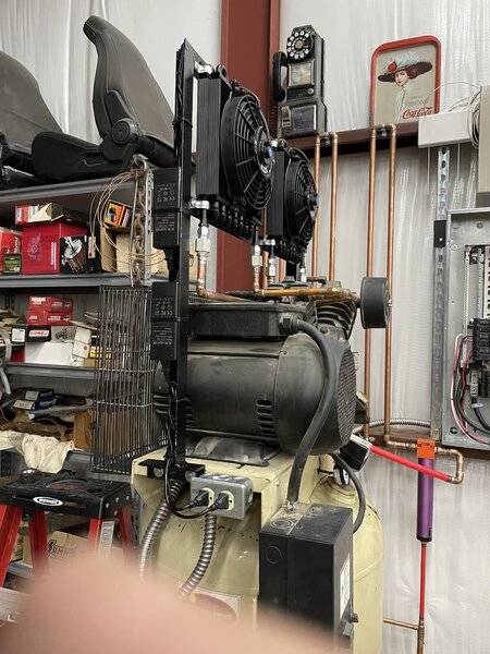

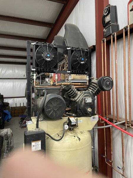

I am just finishing up on building one of these for my 7.5 Hp 80 gallon tank.
I am using two tranmission coolers with electric fans that go into about 30 foot of 3/4 copper then to the tank.
I can get pics tomorrow if you like?

It’s done and is working remarkably well. you can actually feel the temperature difference across the coolers with the fans running.
It will be hot going in and cool coming out before it even gets to the separation system.
This is all before the tank.
