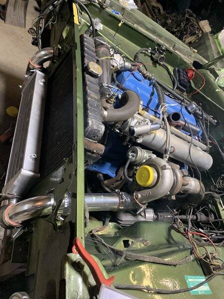

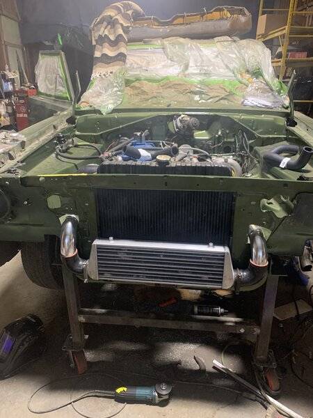

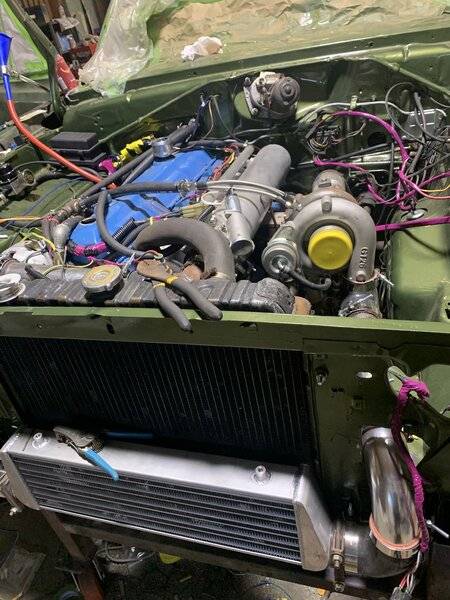

Boost heading my way for my 1971 Plymouth Scamp. I’m looking for ideas and examples on where and how to mount an air to air intercooler. Looking to see how you guys are intercooling your abody mopars, would prefer not to cut the car up too much if I can avoid it.

It's tough with Mopars except for the 71+ B-bodies. I have even though about two smaller ones, wet intercoolers, .. my 'druthers is air to air.
What engine and how much power do you need to support? There is VERY little room behind your grill. Swapping to a dart front clip would gain you 8+ inches.
I understand the desire for simplicity, but air/water may be your best bet due to packaging.
360 magnum engine, supercharged, 500 wheel HP
I believe you’d be looking at a minimum 3” core intercooler. I don’t see that fitting. Unless you’re willing to run without a grill.

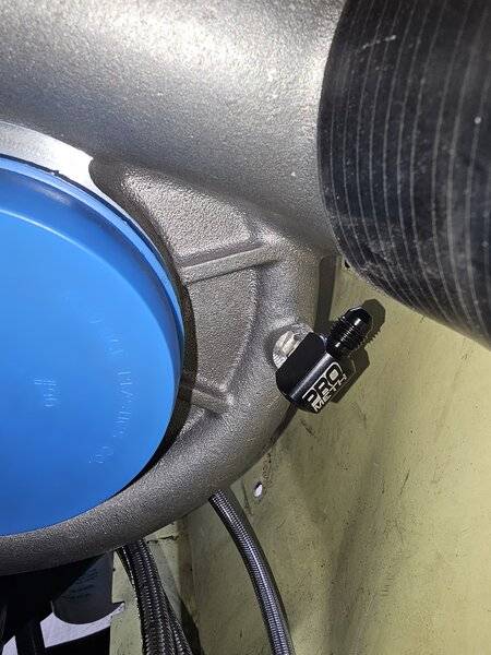

I'm planning on spraying straight methanol into the volute of the supercharger? If that's not enough, I'll add a Chiller fed by my A/C along
