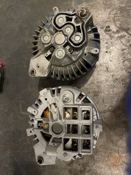

Hello. I went to the parts store to get a new alternator for my 1969 valiant, all original with external regulator. The original is a round Back unit with one field wire and the charging post at the back as it should be (correct?) the parts store gave me a newer style with the square part at the bottom with the internal regulator. Is that ok to put on there? It does appear to have a piece screwed on over one of the terminals on the back that makes it too wide to put the wire terminal over. Is this a way to ensure you just use the one wire terminal i the right spot and this alternator is set up to use with the old system? Or is this just wrong? Any help appreciated! Tanks
This is getting really common The squarebacks, generally are better alternators, if you are not concerned about "restore correct looks." CAVEAT!!!!! Make CERTAIN the modified brush is actually grounded, or it will not charge, and make certain the accessible brush is NOT grounded. That is, it should show a small resistance as opposed to a short, maybe 2-3 ohms or a bit more
The difference electrically, is that the pre-70 regulators controlled power going TO the field, which was grounded
the 70/ later cars had 12V direct to one field, and the VR controlled "the amount of ground" so to speak to control output. Isolated field alternators did not actually start with the squarebacks. The first isolated field alternators in 70 were roundback units.
That squareback alternator doesn’t have an internal voltage regulator.

Looks like a revised squareback. Those don't fit as well, and more likely to burn out the voltage regulator because of the rotor's higher current draw.

I want to keep it original as well. I’ll likely rebuild the round back one that was on it. I just wanted to know if this one would work. If it doesn’t need mods I’d put it on for now so I can put some miles on it before the winter hits and to give me time to rebuild it. Thanks
Interesting. Perhaps I’ll wait to get the original fixed up to avoid issues like that. I want to keep things original, it’s a pretty nice survivor car. I just wish I got a direct replacement from the parts store, maybe I’ll ask them to see if it’s possible to get an exact replacement. Thanks!

This is easy. Do a current draw test. If the rotor is drawing a lot more current than the shop manual specifies, there's a good chance the regulator will fail sooner. More current through those small wires is more heat.
A revised squareback was designed from the begining with rotrs that draw more current.
However a roundback or regular squareback that has been 'rebuilt' could have a rotor that also draws more than stock. So its worth checking.

A 'squareback' will draw a bit more. I've measured 3 amps on an original and 5.8 amps on a remanufactured one.
3 amps I wouldn't worry about. 6 amps I think is pushing the limits.

In the first post, 65Valium shows us two DIFFERENT alternators.
The one on top could be the original with a new rear bearing or replacement that looks similar.
We do not know what rotor is in it. It is the mainly the rotor that drives the field current.
It could have a rotor for a Chrysler built '60 amp' alternator even though that was never a standard option in '69 (or 70 or 71 or 72 or 73 excepted with the heated back glass). In fact if you go to look up replacement rotors, only '60 amp' rotors are what you will find being retailed now.
The second alternator shown is a revised squareback. That was never offered on any A-body. It didn't even exist yet.
