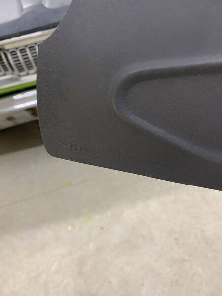

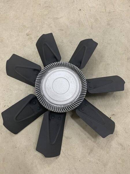

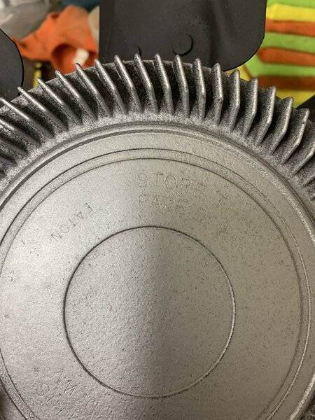

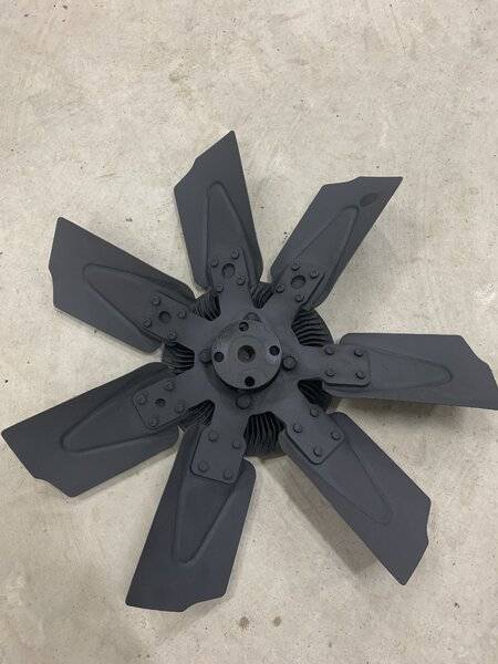

Hello,
I have a 71 duster I am putting back to original. It is a H code non AC car. I have a clutch fan with PN 2863 216 stamped on it. It is a 18.5” 7 blade fan. Any help would be appreciated.
thanks Jim
Just posted this the other day, this is for 1970
The fan on my '71 Non AC H code Demon is a '215. It's 18". Not sure about the clutch.
The chart above is E body I think.
70 barracuda would be a E body, so look it up in a 71 manual. It's in there.
Wow, 1 1/4" wide blade for a/c ? you think It would be the wider blade.
