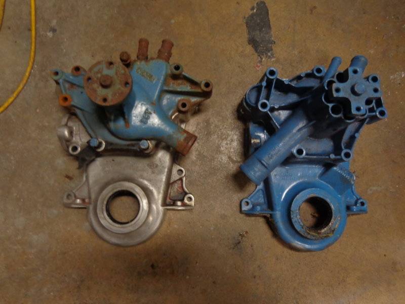

Ok, here it is:
Here is the early style 64 - 69 location with the timing tab as on the 64 - 68 models:
Here is the 70 and later configuration...
Here they are side by side with the early 64 - 69 location on the right and the 70 and later configuration on the left...

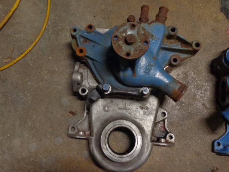

Here is the 70 and later timing chain cover with the 64 - 69 cast iron water pump on it...

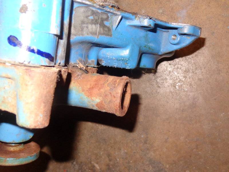

Here's a side shot of the 70 and later timing cover with the early 64 - 69 cast iron water pump from the side... The radiator hose outlet blocks the timing marks for the vibration damper...

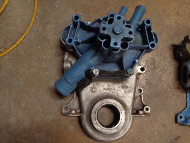

Here's the early style 64 - 69 timing cover location with the 70 and later aluminum water pump... The timing tab will not seat properly as it interferes with the lower radiator hose outlet....
Here's another angle....

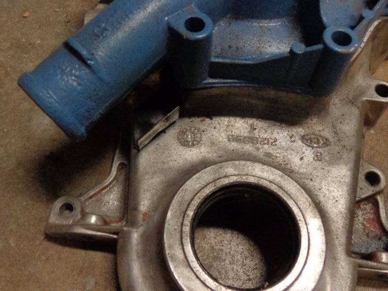

Here I put the timing tab under the water pump to simulate the 69 timing cover with the marks cast in... The vibration damper marks will also be blocked by the lower radiator hose outlet...
If you want to do it right, keep the timing chain covers and water pumps together for the early and late style configurations and make a new mark on the old vibration damper that came on the engine that you are using....
So in that case, the harmonic balancer would also have the timing mark in the incorrect place too, if there was to be a conversion to use the opposite side w/pump outlet, conversion would need :cover, balancer, w/pump and brackets. View attachment 1715334133
The way around that is to use the vibration damper for the engine and crank that you are using and put the engine to TDC with a piston dead stop tool, then make your own marks on the vibration damper to match the marks on the timing chain cover...
I prefer to keep the proper vibration damper with the crank that it was originally made for and make a new mark vs swapping vibration dampers on cranks and risk having a vibration problem... That way you are not mixing vibration dampers from forged and cast crankshafts and having a vibration issue... Keep the vibration damper that was made for the crank together with that crank and make a new mark to match the new timing mark location on the timing chain cover... A piston dead stop tool only costs $10 and will enable you to mark the true TDC location on the crank to the timing marks on the timing chain cover... It's easy to scribe and/or paint a mark on the damper with paint or white out...
