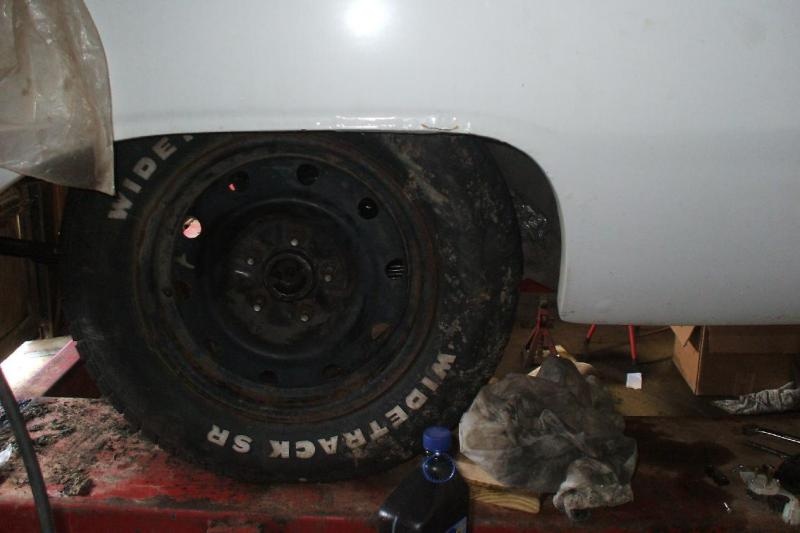

Jr how's the body on the white car?
Its not perfect. It is a pretty solid car but needs some work. It was restored in the early 90's where a small patch was placed on the drivers side floor, a little bondo was used in the quarters, but done correctly and nicely. You can see the little bubbles above the wheels where it is starting to go in this pic:
attachment.php
Frame is solid, has the mini tub about finished (will be done before being sold).
Still has the all factory V8 K-frame and the 318 out of the 70 Dart is going in it.Fenders are solid and doors are solid (may have a small bubble on one of the doors that is starting but nothing serious.
