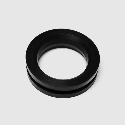

if you're leaking fuel and the tank is new, i'd suspect the fuel neck tank grommet or the sending unit gasket.
also, obviously, if you have any type of aux fuel pump check all the lines. sounds like these dudes were sloppy or lazy or both so it might just be loose fitting/clamps. thankfully all of that is easily remedied.

You should be able to see if the lock ring/sending unit is leaking just by jacking it up, no reason to drop the tank. Even if it is leaking from the filler neck grommet that can be remedied without dropping the tank, access possible through the trunk under the mat.
linc hit it on the head. you should be able to visually ascertain what and where the leak is coming from; and it's not necessary to drop the tank to R&R either of those.
