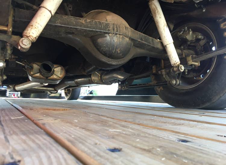

Just blew up my rear end VIDEO

This rear has been beat and put away wet fir long time. I’ve been beating on it for 6 years now. It’s time had come. Lol. How narrow did you cut the rear

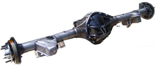

I just had it cut to stock A body length with 8.75 axle ends to get rid of the C clips.
I feel sure being the 489 case the crush sleeve is what failed. They cannot take a boat load of power. If you go back with the 8 3/4, use a crush sleeve eliminator kit. They add some strength.
