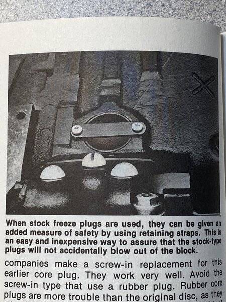

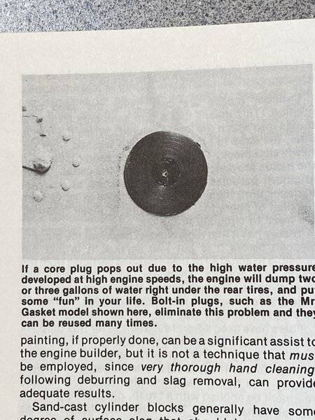

What about these Mr Gasket screw in style? They even make these anymore?? (And no, I’m not talking about those in a pinch rubber expanding butt plugs that pop out on you) Or how about the old strap trick? Easy on the big blocks, not sure if there’s enough flat material to drill into on a small block. I’ve read of riveting them somehow but not sure how easy that would be....
