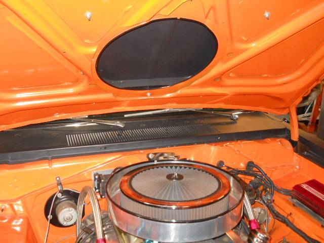

My Duster I originally cut the hood for that factory air cleaner ram air system that was in a old mopar action magazine. After I installed the Indy intake I had to make a breather or it would have been to tall. Same car just orange at the end of its life Started life Bahama Yellow.
