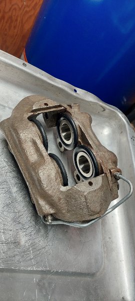

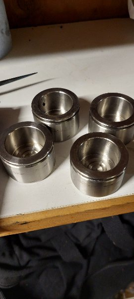

I bought a rebuilt set of KH 4 piston calipers with SS pistons from Online Caliper who were reccomended a few years ago by someone on this site.
The owner, Mike has now retired and sold his business to a big company who has no interest in old calipers and refused to honer the guarantee when one started leaking. Mike did his best, including taking my caliper and putting it on the "big-wig's" desk, but he refused.
I had my caliper sent back to me and found that Dorman sells a rebuild kit which I installed. I had never rebuilt a caliper, so it took some effort. I chose not to unbolt what appeared to be a way to split the caliper in two. Maybe I should have, but I managed.
For those who have not done this and wonder how it is done, I will say that I first cleaned everything, then put the new o-ring like seals into their grooves within the caliper, put the larger dust covers completely into the caliper grooves making sure they were in all around, and pressed in the pistons.
The first two I did by hand but it was really difficult, so the rest I did with a fairly large channel lock, carefully alternating firm compression from one side of the piston to the other. With a little persistence each piston alighned itself and began to go into it's cylinder. Before going all of the way, I used a dull pick to persuade the dust seal upward and over the piston, then into it's piston groove.

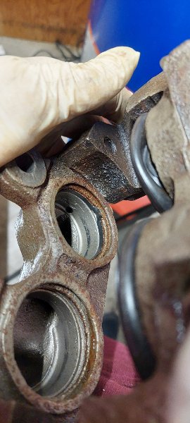

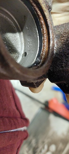

I am attaching a picture showing the cause of the leak on my lifetime guaranteed caliper piston which in the end was not guaranteed at all. I am really glad I chose the SS pistons which should now perform flawlessly for a "lifetime".
