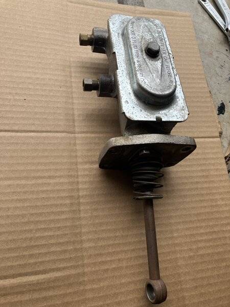

Long story shortish, have a 65 valiant, awhile ago had done the duel reservoir master where I ran the back res to the from drum distribution block, and the front res hardline straight to the rear rubber line. Was planning on doing the same but had seen a post where some recommended using a larger reservoir master for the disks, attached is a pic of the original set up,

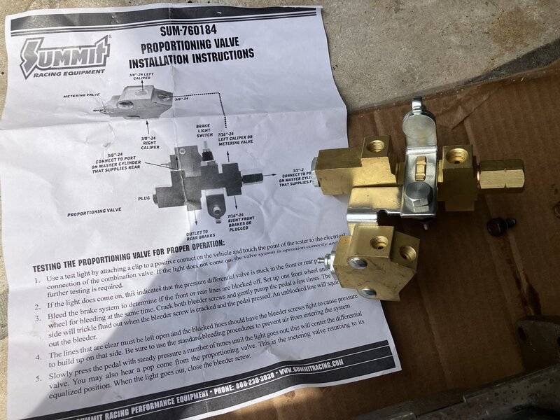

Thought about moving to this (pic below) master cylinder as it looks like it would work with the current rod set up ( I think the bore may be different) and using the summit proportioning valve (only the small block on the below pic) to run the front disks, and hardline again the other reservoir to ur rear drum rubber line,
Questions - would the original master cylinder truly be too small of a reservoir for disks and would it hurt anything to bypass the distribution block (rears only) and run the hard line straight from the master to the rear rubber line? I put frame connectors in the car and was going to run the brake line on the inside of them, instead of drilling through them, this would make the new SS front to back line to long but if I ran it to the master cylinder it would be a ideal length.. any info is appreciated
Yes A larger resevoir is recommended because as the pads wear, the piston starting positions move outward.

For the pre-'67 set up, you must the proportioning valve in the feed to the rear line.
With the tandem master you can use the prop valve in the rear line, or a combination valve as was used by the factory 70-72.

If you are going run manual brakes a 1 1/32 master cylinder will require excessive leg effort to stop the car. Something like a 15/16 bore master cylinder would be a lot less leg effort.
And you won't need a proportioning valve if you run 7/8 wheel cylinders in the rear.

As for the way you have it plumbed now you don't need the 70 something distro/proportioning/brake warning block.
You have the rear most cylinder going to the front brakes, the front most cyl going to the rear brakes with a proportioning valve in that line.
I would get a 67 to 70 disk drum master cyl.
The 1- 1/32 bore is 0.031 over the stock 1" bore. As mentioned slightly more leg force.
15/16 is 0.0625" smaller requiring less force but more travel.
Personally I wonder how many 1" bore MCs have been rebuilt so many times that they are 0.030 over from the rebuilder.

So an adjustable valve (which he already has) would be IMHO the right way to go
I basically did what Dana describes, except I ran both front and rear lines through the metering block as per factory installations, then added the proportioning valve to the line going to the rear axle. This is very easy to do without cutting and flaring if you just buy a short (15" or so) pre-made brake line and bend it into a loop, then install the proportioning valve on an angle bracket parallel to the metering block, offset by an inch or two. The rear line just moves over an inch to go into the proportioning valve, and the loop connects the PV to the metering block.
This was on a factory drum brake 1967 Barracuda convertible — I duplicated the setup on a factory disc brake Barracuda (K-H discs and 10 x 1.75 drums), with the exception of using the 72-up metering block and Summit proportioning valve. I used a 15/16 disc brake MC with no booster. Once I had the PV dialed in the brakes were excellent. But I had to dial the PV out to something like 80/20 front/rear to keep the rear brakes from locking up. For this reason I would recommend an adjustable proportioning valve.

The proportioning valve doesn't begin to play a role until line pressure is up around 300 psi. or something like that.
Its in the pamplets I linked to above.
They also explain the concept and why its used so I'm not going to repeat it here. Whom am I anyway? Some guy on a keyboard. Take it direct from Chrysler Tech.
thanks for all the info, I don’t think the metering block/prop combo I have from summit is adjustable,
one question …looking at the later drum disk master cylinders, mine has a bolt on spring and boot, the newer models do not, should my rod work ok just removing everything but the rubber that holds it in the bore? Thanks all
