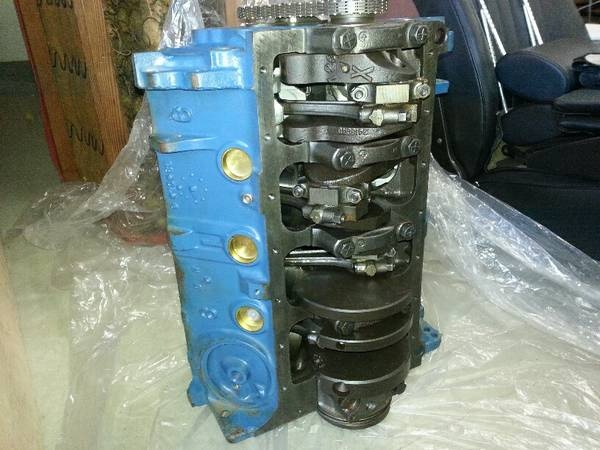

So I just bought this. Guy will deliver it tomorrow:
http://spokane.craigslist.org/pts/4336595143.html
360 re-built roller block - $400 (rathdrum)
this is a '89' to '90' 360 roller block that's been re-built.have had it for some time don't need it any more. if answering machine on please leave message. 208 687 XXXX
I'd like to stay mechanical 'cause I just LIKE 'em
But what are my options with these roller lifters?
Pushrods? Anyone dealt with these rollers and 273 cast rockers, IE pushrod length?
Cam? If I use these lifters, what's a good cam? Like to stay with something "equivalent" to the old 340 cam "in modern form"
This is a VERY low budget engine. I was just going to re-ring a core I have, but for this money, I could not pass it up.
Of course I don't know what cam is in there NOW, but surely a "truck" stocker etc.

So are you sayin you wanna solid roller? I am sure it's a hydraulic roller now. If you want "good" and "cheap" (rare in the same sentence) Oregon Cam Grinders is very good and very reasonable. They can regrind your hydraulic roller to a solid roller if that's what you want.

Oregon can map it for you and give you a cam card on it. They can even regrind the hydraulic roller into something with similar specs with roller lobes. Check out all their grinds here:

Why go back to a flat when you have a roller block. Use the rollers.
