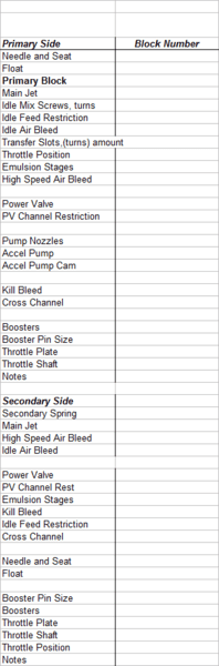

If you are going to measure with pin gages, might as well map everything out.
My spread sheet looks like this. Not all of it is important.
I use the same sheets to document changes. Then I add test letter-number and date to the column.
