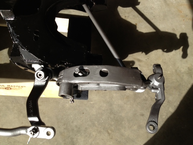

Here is a 63-66 Centerlink/pitman/idler setup
Here is a B/E body with the fast ratio pitman and idler and the corresponding centerlink.
Notice the stud bolts are showing from the bottom of the K-member. Where as in the picture above that bolts are not seen because they are on top.
attachment.php
Here you can see the side profile of the fast ratio pitman and idler.
attachment.php
Like Jim said you can fab a thru mount idler support that mimics a 68-72 K-member idler mount. That said, all the fast ratio pitman and idlers I have seen have centerlink ball joint studs that point downward for 70-74 E-bodies. 63-66 A-body centerlinks have pitman and idler taper hole that only accept pitman and idlers studs that point upward. Here is a 63-66 Centerlink/pitman/idler setup Here is a B/E body with the fast ratio pitman and idler and the corresponding centerlink. Notice the stud bolts are showing from the bottom of the K-member. Where as in the picture above that bolts are not seen because they are on top. Here you can see the side profile of the fast ratio pitman and idler.
