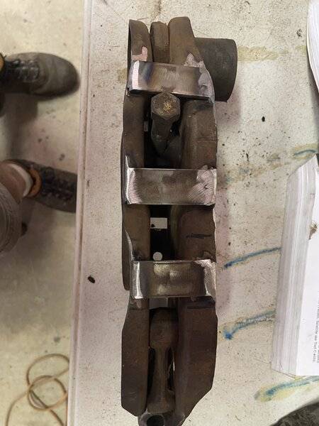

Ok, I’m going poly. Pressed out pins easy, rubber came out easy. Didn’t want to waste cash on Mancini braces so I did it myself with 1/8” steel. Turned out good.
Just waiting on FedEx for my bushings and ball joints and it should be better than stock.
