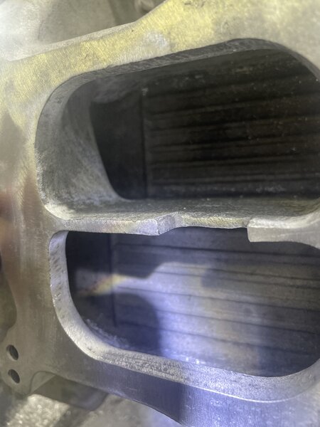

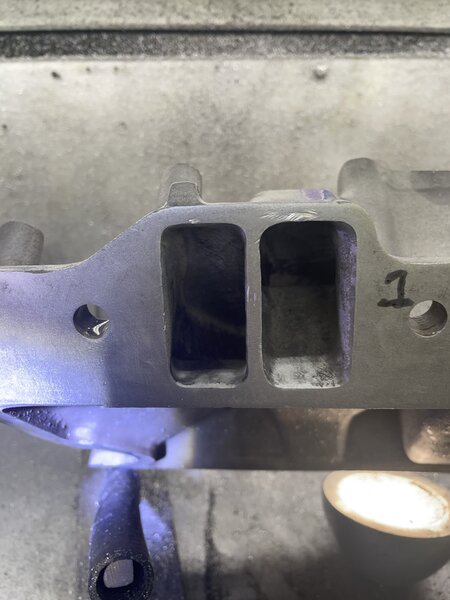

Member Chris I’ll let him step in hopefully to explain the situation a little better but here’s my attempt. He is going to run a class with rules that limit a particular Edelbrock head and he’s limited to an LD340 intake. He’s allowed port work and a bigger valve so he went with a Ferrea 2.055 intake valve. Intake is allowed to be ported. To try something different I’m going to give you guys the head flow numbers. If interested cut and copy the flow numbers and take a stab at what you think the flow numbers are with the stock intake bolted on. Then right across from it add where you think the numbers will be after port work. Keep in mind this is a dual plane intake which really limits the amount or work that can be done. I’ll let it simmer till I watch the steeler game tomorrow afternoon. I went to church Friday evening and Sunday if I hit the shop I try to work on my projects but I’m behind on this job so for a little break from starting on his other head I’m going to start porting his intake. Any questions post them up but no hints on numbers.

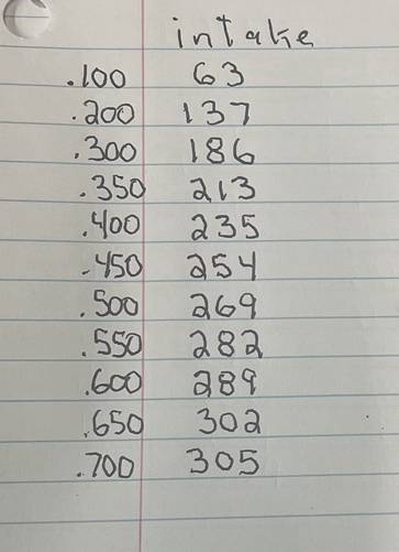

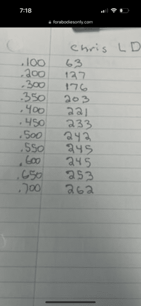

I wouldn’t rush in giving and the big ❌ till we get more info. This gentleman is from the southern states and they play a little differently. It probably not the super Stock class you are thinking of. Ok I got a lot of work done this morning. Pictures coming after I eat but here are before porting numbers (stock)

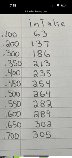

now those numbers against a stock TQ intake

So @pittsburghracer the numbers you posted above, just so I’m clear.
This is intake port flow on bare heads.
And this is intake port flow of heads with an LD340 that you haven’t massaged yet.
Are both of those statements correct? Or is the second pic intake flow on one runner of the ld340?

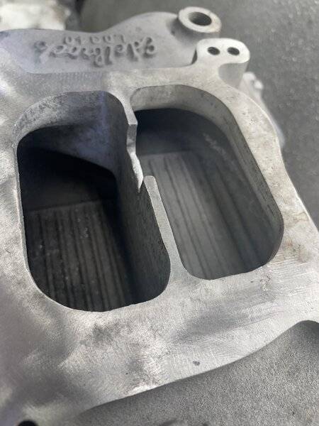

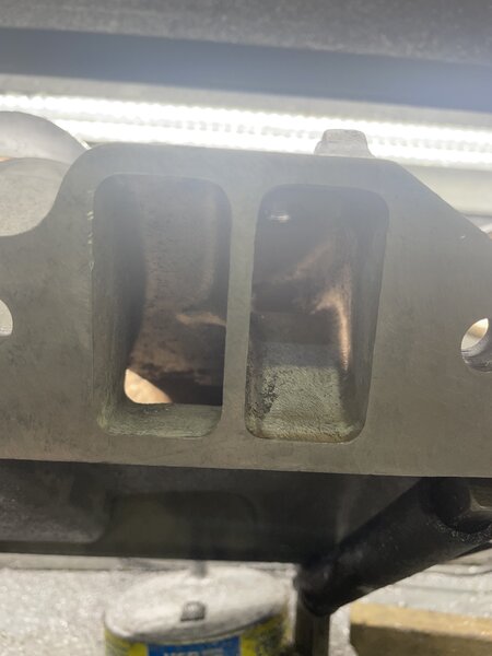

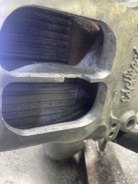

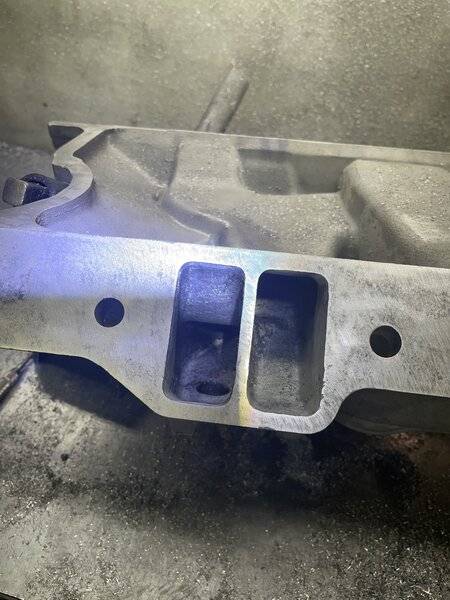

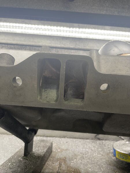

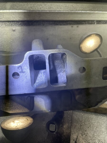

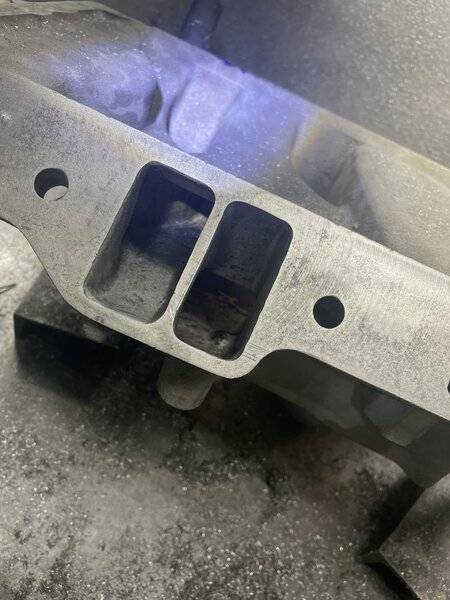

It is hard to take pictures of any intake. A dual plane intake is damn near impossible because of lack of lighting. There’s a lot of radius work you can’t see in those photos. In some areas there are three radius’s stacked on top each other heading to their runners.
