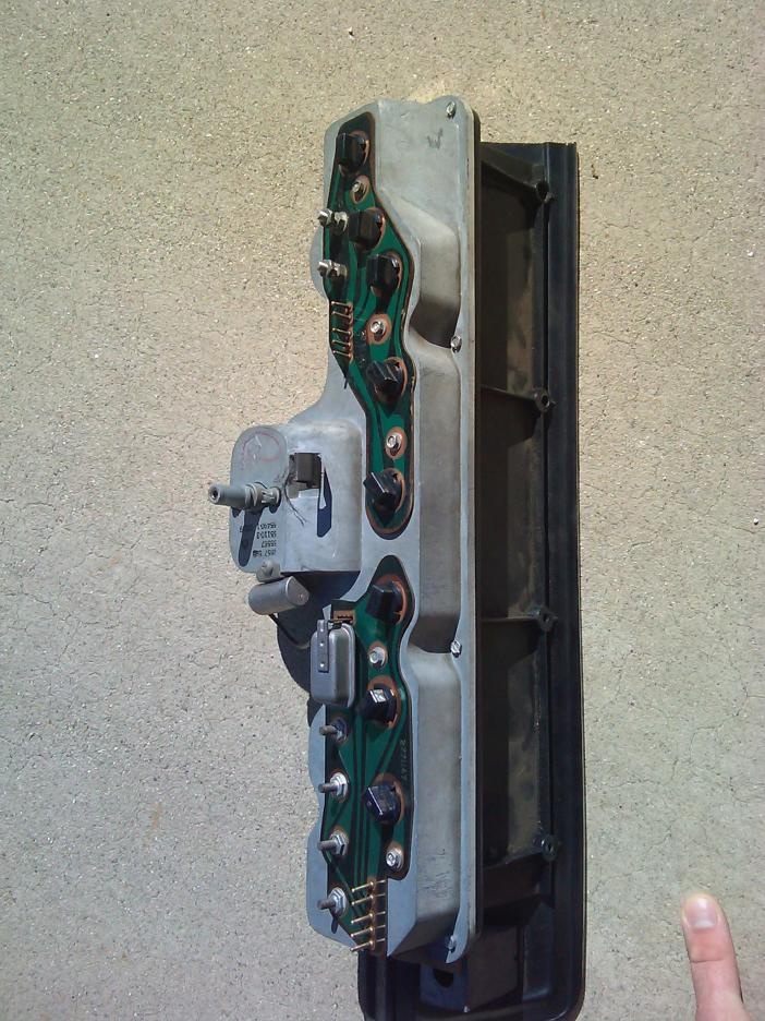

B.I.N.G.O.! That is whats in my dash! My Rally dash has 4 for the gauges. I used the white leds for the two turn indicators and the brake, high beam indicators since they have colored filters. Heat in the cluster is gone!! Also power draw is minimal too. Good for the headlight switch! Can't really dim them though. They aren't quite as bright as the photo shows but are nice, I like'm. When I find a better cluster bezel I will also get the rope light to go around the inside of the bezel where the gauge goes for better coverage. I finally got the bulb socket for the amp gauge so it is brighter than the pic shows now. The blue leds act like a blacklight and really make the orange needles glow! I purchased the orange needle paint too. Here is a shot with the bulb not working,

ok well i got some of the bulbs in, and ordered more of the twist on sockets...
i did colors for everything, i didn't want to rely on the plastic tint things in the dash and im glad i didn't becasue WOW! the turn signal indicators are amazing LOL... my hi-beam light isn't working but im sure thats dash issues...
anyways i'll get pics up tonite when it gets dark...
and so you guys know i went with 90* bulbs for the indicators and 120* for the back lighting for the dash... they had 360* ones that i might try if its not enough but will see...
got them all in but two blue's so its a little on the dark side still, also with those cobalts its hard to compare... probably could use a stronger bulb or one of those wide angle ones...

Each of the holes has a blueish green filter riveted inside the cluster. I removed those and painted the inside bright white, blacked out the original spots where the light bulb shines directly at the backside of the bezel.
You should do that and repaint the needles. Also clean each gauge face to make the white silkscreening pop. The stock black gauges will never come close to those Cobalt gauges but you can brighten them quite a bit.
