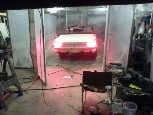

I don't understand what all the hupala is about LED tailight and parking bulbs.
I have been using LED tail light bulbs just like Mike69cuda's for several years. I purchased them off eBay for under $10 for 4 bulbs. No modifications. Just plug them in. Like Mike, I left the stock bulbs in the park lights. Early Barracuda park lights are the coolest at night.
I installed red LED 1157 (brake/turn & running) that look like in Mike69Cuda post 6. A bit brighter than the filament bulbs and the red makes the lamp look red (not yellowish) and more uniform. Just put similar ones for the 1156 running lamps in the trunk lid to match. Look for many SMD LED's for uniformity and an end projector lens, often with 3 brighter SMD LED's and at least 3 W for more brightness. Avoid the older LED with individual glass bulb LED elements and only use white ones for backup lamp, unless you prefer yellowish brake lamps. More info in my turn signal thread.

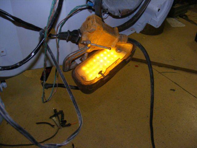

have a write up on those? Thats exactly what Im wanting on my 65 dart.
they are on this forum I'm making a set for a friends 65 but the reverse lights are not quite bright enough for me (or him) yet. I custom made my 66's and it was a chore getting the right lumens to actually be "legal" if I had to DOT test them, unlike the ones that some companies make for the later darts and dusters. they are pretty but not really lumen legal. Mine would pass the DOT inspection for lighting thnaksfully since I don't want to get rear- ended after all that work:steering:
Are these something your selling?
once I proof his 65's and we are satisfied with the reverse led setup then yup, I'll be making the 66 and 65 set. I have already made an All 4 turn/tail/stop harness for my 66's and will see if the 65's can be made to work like that also but with reverse light also. there is a LOT of holes to drill and I want to try surfacemount tech on the next generation of leds.
