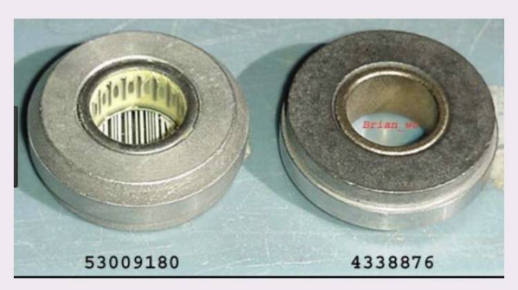

I have been looking for this specific pilot bushing for a long time no luck only one I could find is the roller bearing to the left
