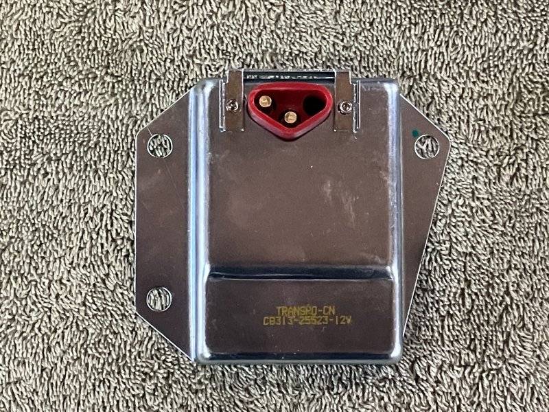

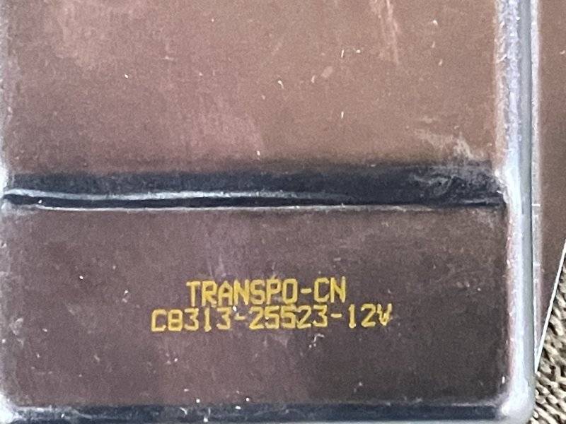

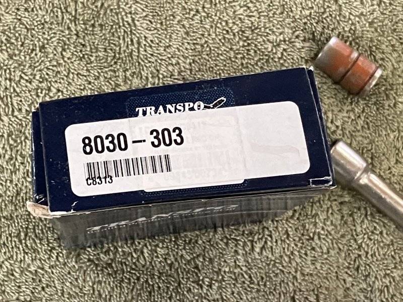

Yes, regular high output alternator but the regulator is special:

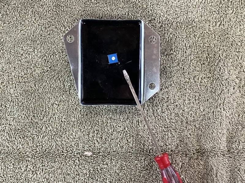

Adjustable on the back side using a small standard screwdriver.
