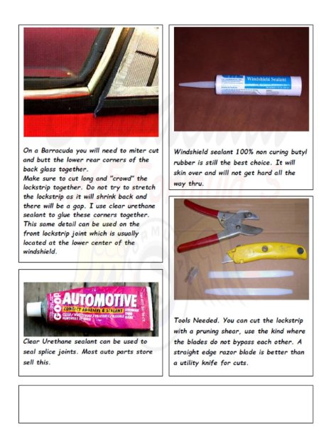

I have the original metal covers, but they do not fit the profile of the lockstrip sold today, because of the different outside round profile, not the original indented type. One of the suppliers of the lock strip on eBay shows installation information in his listing on an early Barracuda (see below) and recommends cutting the ends of the lockstrip in the bottom corners so that the ends come together at the proper angle, then gluing them together, which looks fine in the pictures shown with his instruction sheet. Has anyone tried the Classic Industries corner covers? Do they fit properly over the new lock strip? There are no written reviews on the Classic industries site for the (pricey) corner pieces, but they look like they would fit the new lockstrip profile. Would appreciate feedback from anyone using either method for recommendations.

Worked on these new. Customers would come back with moldings badly shrinking after only 2/3 years. We would have to cut the strips on the sides and install long straight clips.
Murray, Thanks for that info. I am concerned about shrinkage too. I'm thinking of ordering the the covers from Classis Industires and see how well they fit. They would allow for shrinkage unlike the butt joint.
