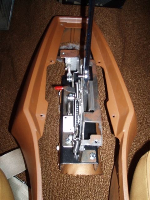

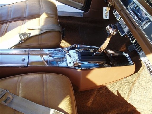

my shifter started out as a b & m quick silver. i made my own shifter arm and cover. i ran my cable inside a length of 8AN braided hose. then i ran it thru floor and down the passenger side of trans. then around the front of the inspection cover by torque converter right in front of trans pan. then it circles to the cable bracket. mine has worked perfect all summer.
I run a Quicksilver as well. The hole in the floor has to be directly ahead of the shifter, as the cable can't bend much in that short of a distance. After two burned cables I routed mine up over the bellhousing and back down and anchored it using the hole on the trans that the kickdown bell crank used to occupy. I am using a lokar kickdown. The cable is inside a silicone catalytic convertor hose with a DEI sleeve over it. So far no problems.

Excellent picture! Making use of a bolt to hold that metal band (AKA bracket) to hold the cable away from hot headers. I made that mistake once. A zip tie fixed it. I like what you did better.
I split 3/8 fuel hose and zip tied it over the cable to protect it from the heat.
i ran mine @2 " in front of shifter and used the same insulator (velcro) as qkcuda, its tight but very doable (my first cable lasted 4 days without insulation,but has been on for 2 months now with no problem)also used metal ties as a stand-off from my tti headers
