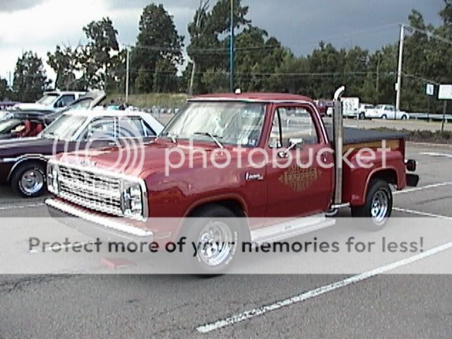

but in the meantime, Ive been reading alot lately and i'm trying to find some info on a 79 360 block. Its in a Lil Red Express, and is the origional. I cant get to it to get casting numbers and whatnot at the moment, and i realize that limits specifics about it, but i was wondering if somebody could offer up some general info about blocks in that year. From what ive read thus far, i guess there was atleast 2 types (an X block and i guess a standard block?).
anyway, im looking for stock numbers like bore/stroke/etc. any info would be appreciated.
Im looking into maybe doing a stroker in it and i was curious how big of a stroke you can go without having to get into alot of heavy machine work (dont want to bore it or anything). Im trying to stay on a smaller budget, probably $2500~.
i realize theres alot to consider when doing a stroker (or anything to an engine really), but this is only the beginning of my research.
the LRE is my dads...
