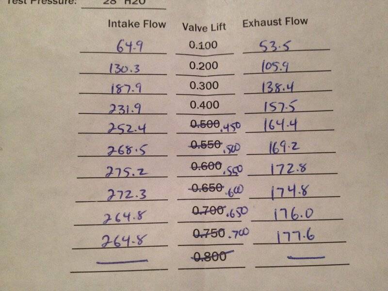

Looking for X Head Picture
Mine, X’s by Dwayne. PRH

Here are mine [j's] that I'm running on a 410 right now.
2.02-1.60 11/32 undercut at the stem and back cut, exhaust valve are ferrea.
.100 75 52
.200 142 101
.300 200 141
.400 249 169
.500 278 180
.530 281 184
.600 248 187
I used a harbor freight grinder w/ 3 different shaped '3 1/4'' long shank' carbide bits, and rolls to do a lil polishing.
Good low lift but drop like a rock at higher lifts. Always a trade off.

Believe it or not, I didnt push these to the max.. I stopped when I hit those big mid lift numbers and just dialed the cam to exploit them. Cam for the heads and rpm. **** was so good I didnt want to trade off fat mid #'s for higger lift flow. One of the ports actually touched 290... hmm 284.. 6 cfm.. 290.. ahhh... while i was working on them.. musta been when the bench uncalibtrated itself...
I was still very green then. The goal at the time was to get the port volume up for the 4" arm net around 270 CFM like the RHS HEADS that were the rave back then.
