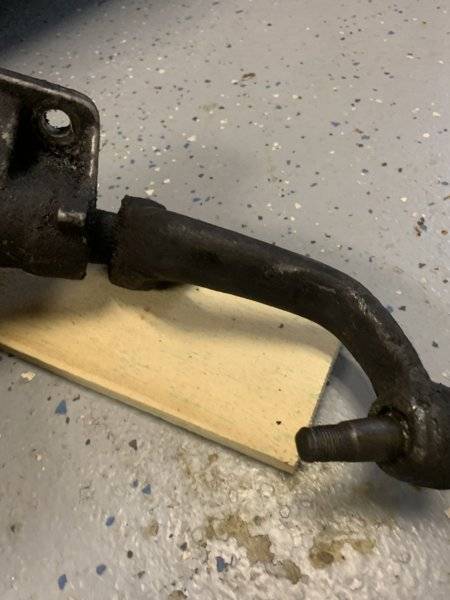

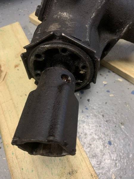

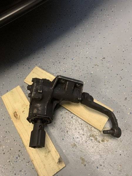

This is what I have. Does anyone know how to take this apart? Thanks

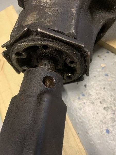

Thanks I didn’t see how to take off the steering Coupler. I took the pin out but it’s still stuck. I soaked it with Liquid wrench because it was rusted.
I just went thru this on a seized one, ended up putting some thin pieces of wood on the steering box, and used a pneumatic air hammer with a pickle fork attachment to remove it.
I got the pneumatic pickle forks from Amazon.
Great I’ll try that. So there isn’t anything else holding it from coming off right? Other then the pin. Thanks
