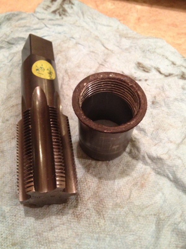

attachment.php
Oooohh.....I'd never seen that setup! That's clean! I've always rolled with that welded-on flat washer trick!
Yeah that tap idea is nice! Is that 1-3/8" that I see on it?
Yes 1 3/8". When I looked on EBAY there were others.
Just put the tap in the vice and screw the arm onto it.
Makes a tough job simple.
