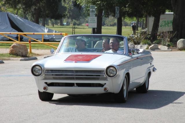

Front was already lowered a little after replacing a few suspension parts.
I didn't like the stink bug look so I read up on lowering the rear on this forum and decided to flip the rear spring bracket's.
I definitely like it, has a slight rake and best of all it was free.

I like. What does it measure from the ground to the bottom of the rockers? Dennis
Thanks
Measures 8'' front,9'' rear @ the sill in front of the pinch seam's,if that makes sense.
Tires are 205 on 14'' rims rear and 195 front.

Dart4forte do you have any side pics ?
