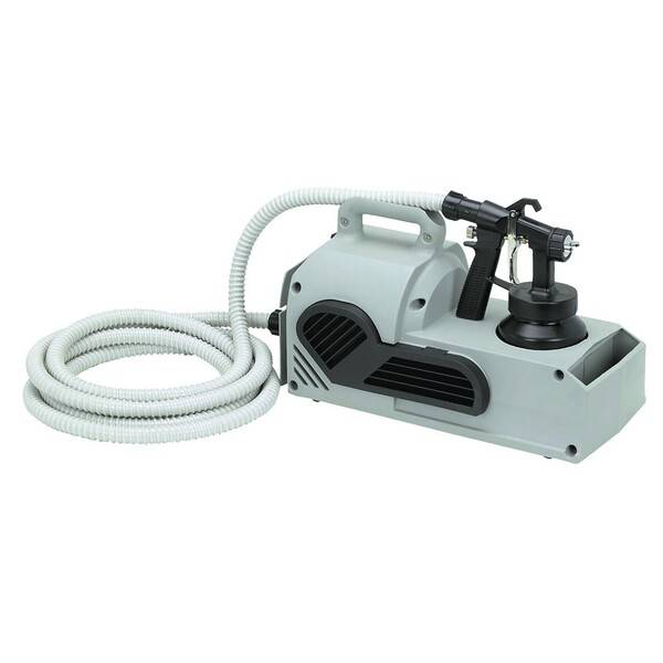

Any one know what this thing can do? Self contained turbine compressor ....Damn the tank compressors!
