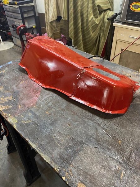

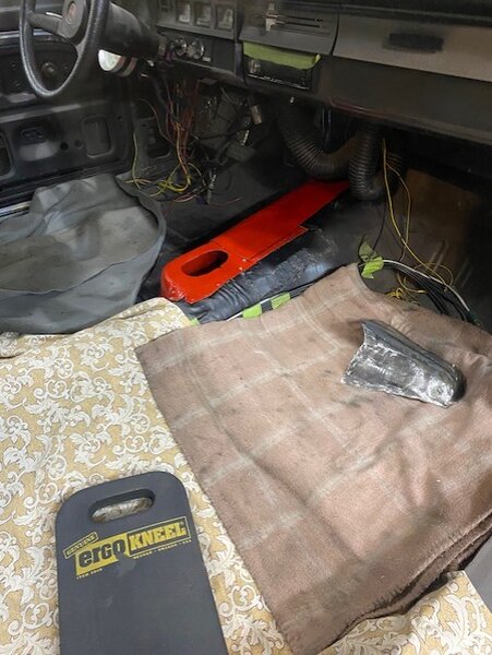

Also going to LED the taillight part only on all four and then use the bulb sockets for stop and turn on both quarter and trunk mounted lights, The water proof LED's I am using for taillights are 400 Lumens, more on that to come, I also refused to pay the inflated price for a 4-speed tunnel hump so I made my own out of a $50 67 Chevelle one and cut and pasted and made my own center section, almost done

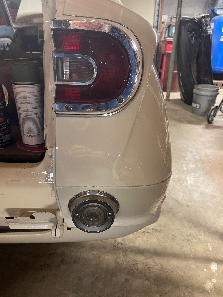

On my 65 Dart sedan delivery my red outers function as brake/taillights with the backups now functioning as amber/yellow turn signals with separate backup light courtesy of a 63 wagon
EDIT: i ought to get the wife to take a puc while I light one of the turn dignal. In lieu of that, here’s a closeup of the amber bulb. I’ve modified the wiring to have separate turn signals from the brake lights
