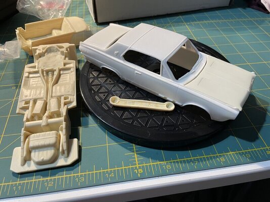

I picked up a 1965 Dodge Dart resin kit and am going to make a clone of my car. I expect it to take like a year to build since I have limited time to work on it and it requires extensive kit bashing. I thought I’d put up a thread to document my progress as I put this kit together.

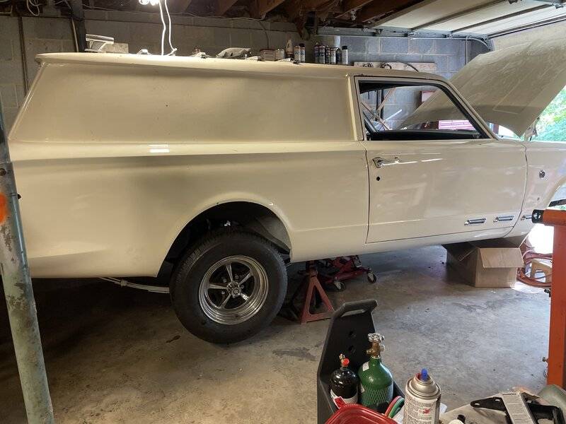

Here’s the car I’m making a mini version of.

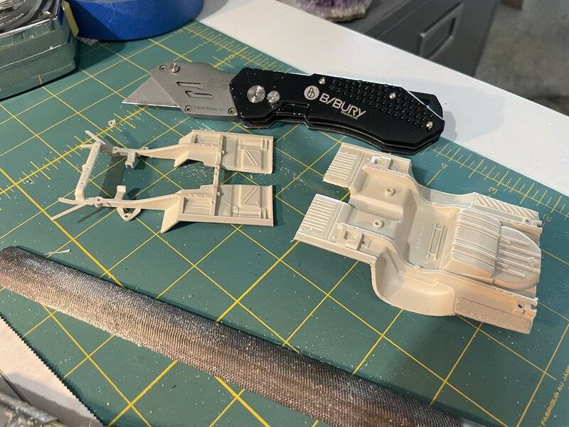

So here’s the kit and the basic undercarriage. I decided to go with kitbashing a different undercarriage from a 1969 Dart kit for more realism and an actual suspension. I cut the 1969 undercarriage in half and shortening it to fit.

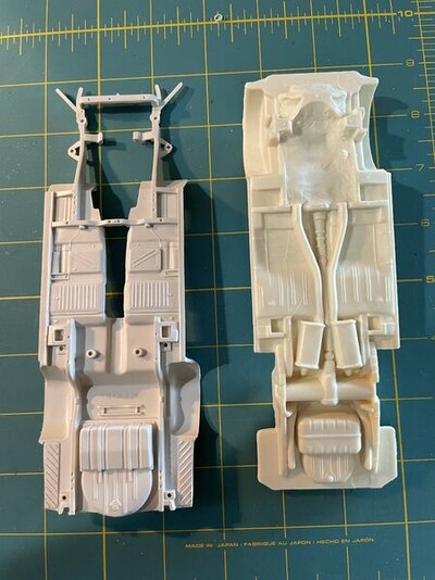

Test fitting undercarriage for adjustments and check for stance.

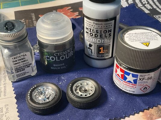

Painted a prototype rallye from a 1971 Duster AMT kit. Wrong tire but it looks pretty good.
Nice work on the wheel! I never got that far into detailing, a little flock and some plug wires is as far as I went. Love watching you guys make these realistic models. I'd love to have models of my cars.
After hours of scraping and filing, finally got the undercarriage and suspension at a stage I can start custom making other parts.
