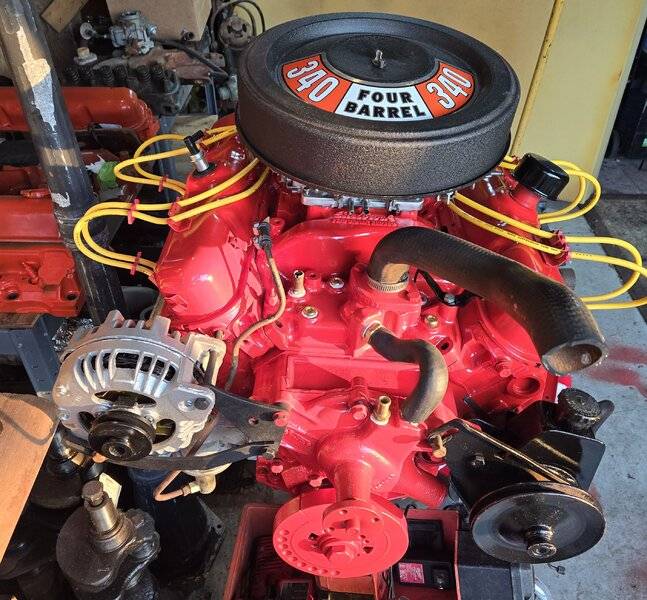

the image is my 68 motor this spring after I remove the 318 and repair it the 340 is going in and the 318 will go in preservation.

I'd pull it apart and see what you have for damage. The timing tab looks far away from the balancer in your pic. If your other cranks are good, not rusty; spray them with Fluid Film and bag them to prevent rust.

The 68 engine on the stand has been disassembled painted, properly prepped for new gaskets and a set of arp bolts. Good eyes on the ballancer but it's just pushed on slightly. The only gaskets on that engine right now r the head gaskets. It's got the correct valve covers correct timing cover and water pump. It's also the correct color 1 yr only 68 340 were born Chrysler industrial red they were only orange in 69 70. Numbscull who rebuilt my 318 got that wrong painted it hemi orange. 69 318 came Chrysler red too. Very handsome in red if u ask me. Orange clashes with my paint, green
