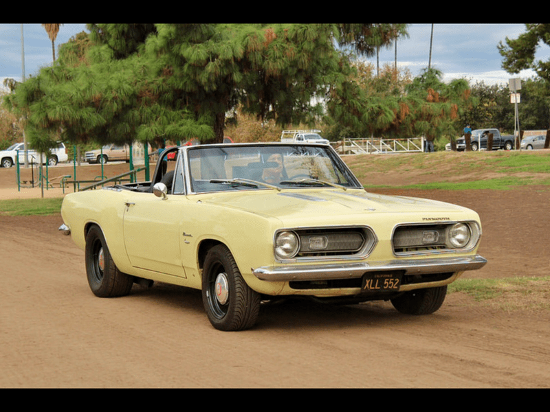

I run that size Nitto Drag Radial on my '68 Barracuda convertible on an 8 inch rim. I forget the back spacing. The tires don't rub anywhere, are rated to 186mph and hook up very well on the street. They don't hook as well as a dedicated slick on a prepared track though.
I do have 3200lbs SS springs, but they fit the same as a stock spring as far as spring size etc. The car weighs 3700lbs without me in it, so it doesn't sit to high in the back.
Barracuda is a completely different animal than a Dart. About an extra 1" to the quarters compared to a Dart. What will fit a Barracuda, Duster/Demon/Dart Sport is completely different than what will fit on a Dart.
