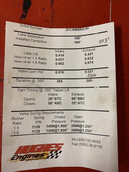

I don't hate roller cams either, but if you can do it with SFT then why not. For myself i just have a hard time with all the money it takes to run a roller cam.
Exactly. Money plays a big part of it. When I put the 355” together I had no extra money for a roller setup.

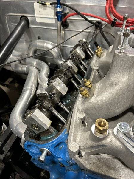

Are the intake runners tapped for nitrous? I bet the launch is special with the 6200 converter!
Those lines are for methanol. It leaves pretty good.
