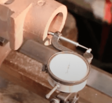

It used the wee dovetail at the top of the spine, kinda like scope rings on a rifle. You can see the clamp at bottom right of this picture

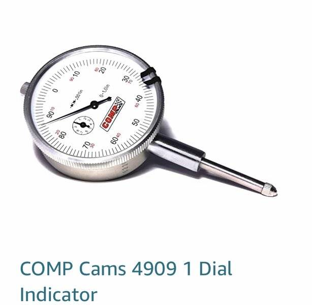

Yeah, I agree with others, you probably want a true dial indicator. That one is a test indicator that you might mount in a mill and run a 360* sweep to indicate that the machine is set up square to the bed.

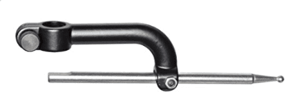

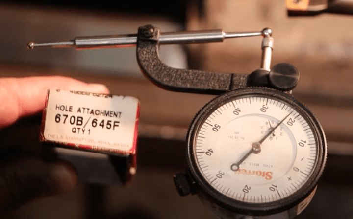

I had a small back plunger Starrett dial indicator set which would work for what you are trying to do. It has a long teeter-totter thingy to reach into a small bore & transfer the movement via the teeter tottering to the back plunger indicator.
It used the wee dovetail at the top of the spine, kinda like scope rings on a rifle. You can see the clamp at bottom right of this pictureView attachment 1715963600

And it can also use the dovetail on the back.

For what you say you want to do with it, that should work. Wish I was home I could post a pic of the accessories I have for mine.
It's basically a piece that slides over the dovetail that screws in to a 3/8 cylinder that can mount in a chuck, and tightens onto the dovetail where you want.
Can work in a mill or drill press.
The little lever can go + or -.
r.

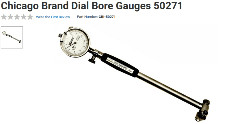

Ahhh! a dial bore gauge! Yeah, those are super handy to map out cylinder walls.

BTW the pictures are from the internet so the number on the box is the Starret version of the tool....
