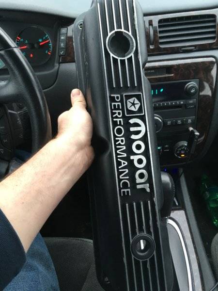

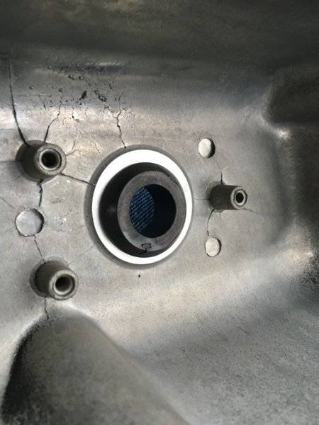

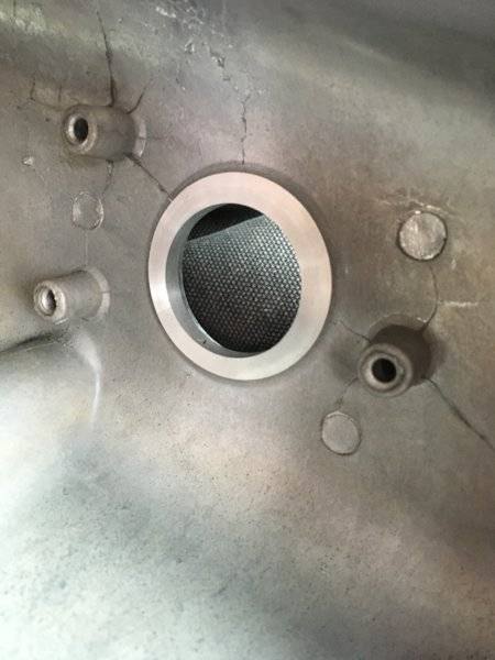

I was going to use two breathers and a pcv. Knocked it out and quickly found out there isn’t a grommet made that will fit. Brought it to my local engine shop and he knocked it outside of the park.
He machined both the top and the bottom so a standard grommet would fit. It's roughly 1/2" deep and a little over 1" wide to start with. (after the knock out is knocked out)

what you really want to show off is the part that is hidden by the grommet
why dont you take it out and snap a few pics of the machined surface?

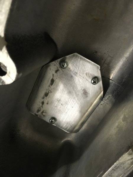

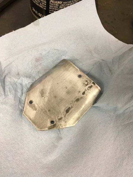

And don't forget to install the baffle under the pcv valve. It prevents oil from getting sucked up into the valve.

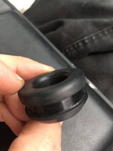

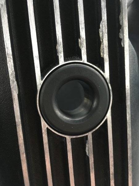

I believe this is what would have worked for you if the breather (or whatever) requires a 3/4" hole. I have personally confirmed this on my own MP cast valve covers - perfect fit (replacing the MP PCV grommet):
Ford Performance Parts Valve Cover Grommet Sets M-6892-F
My photo below. MP and Ford grommets are dimensionally the same except for center hole:
Nice machine work, though!
I have a 360 with this type of valve cover. I also drilled out the "knock out" and installed a grommet and the PCV. Despite putting the baffle under the PCV, I continue to get oil into the PCV, which is causing pre ignition knock. Anybody out there come up with a better way to prevent this? Thanks.
