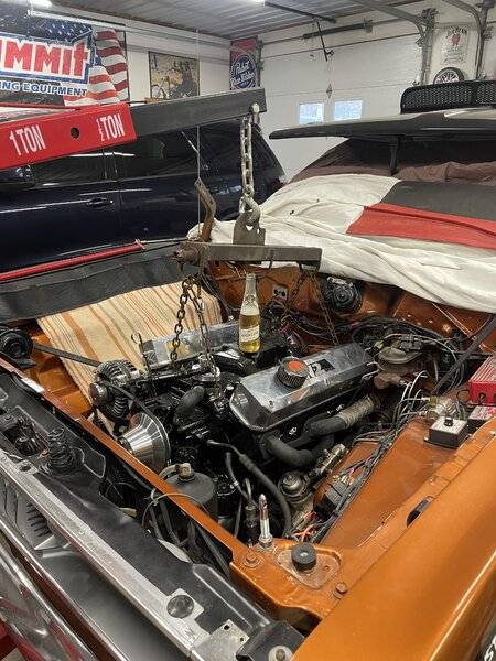

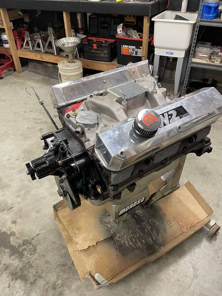

I managed to get things buttoned up over the winter despite trying to spend as much time in the woods hunting with my son as possible. I gathered the last few accessories for the install like pulleys, stat housing, spark plugs and wires, bolts and all the other trinkets that make these things work.

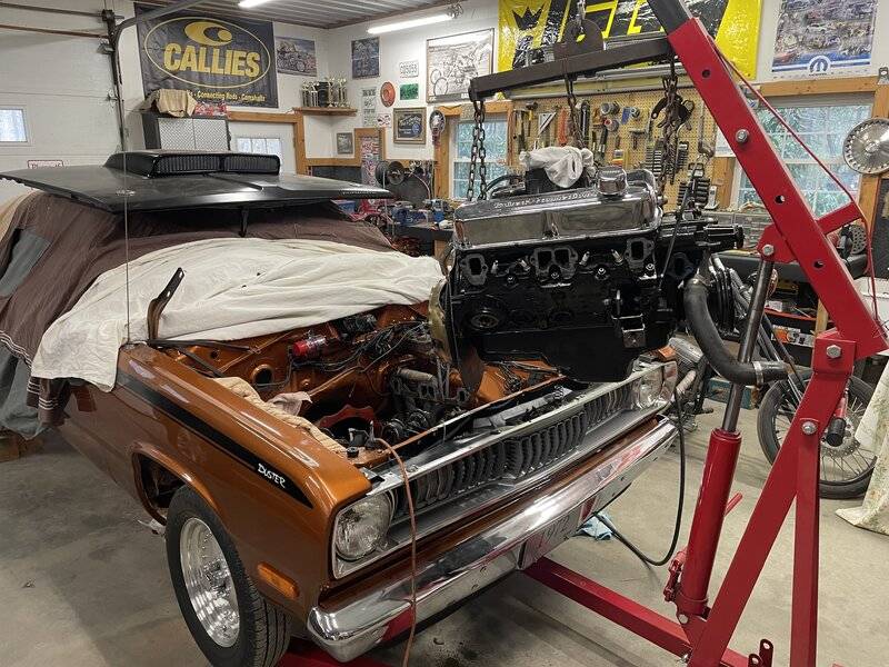

Last night I started preparing the faithful little 318 for its eviction from the frame rails of the Duster and got everything on the topside done. Next it will go up on jack stands so I can disconnect everything down under.
I’m hoping to get things swapped out ad soon as possible since the weather here in PA is starting to turn for the better and before long I’ll be back to camping, and baseball, and working overtime, and etc, and etc, and etc…..

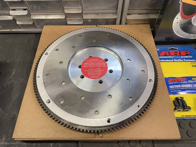

Couple more pieces of the puzzle showed up last week. I spoke briefly with @weedburner (Grant) about clutches, flywheels, and his clutchtamer. I took his recommendation on the Ram clutch and he also suggested going with an aluminum flywheel, which is something I had been considering anyway.
The Ram clutch is part number 98390 and is a diaphragm style. The flywheel is also from Ram, part number 2503 and weighs in at 13 lbs if I remember correctly. New flywheel bolts from ARP will round out the install.
Although this is a 90% street car, I do plan to add a clutch tamer to the Duster for the rare occasion that I get to the track.
Not much left to do before we drop it in. Getting pretty excited.
