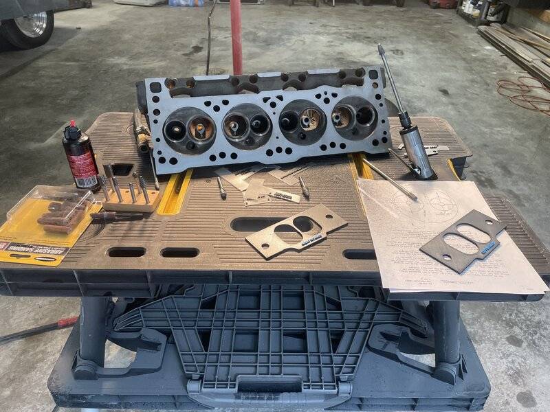

Making forward progress again. Porting the replacement head using the DC porting templates. I’m super busy this time of year between working full time, coaching baseball in the evenings, and camping with the family on the weekends so finding even a few minutes here and there to work on it is tough. I’m picking away at it though and hope to have everything back together before the end of summer

You are correct. The welding process was a failure. The cracks reappeared right along side the weld bead. It was better than it was before welding, so I attempted to seal the cracks from the inside by pouring epoxy into the water jacket and standing the head on its corner. It initially worked! But after reopening the coolant passage in the deck surface it showed a leak again. At this point I knew it was a lost cause and decided to use the replacement head I bought from a member here. After $700 worth of machining, it is now ready to be ported and assembled.
What is the replacement head?
Just like the one it is replacing, it started life as a first generation 810E econo head. It was then machined to remove the rocker pedestals, opened the intake valve to 2.08”, cleaned up the deck surface, cut the guides down for positive seals, and lowered the spring pocket a bit.
