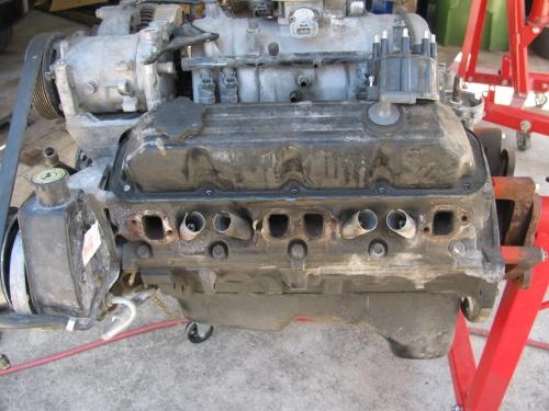

I bought a junkyard 5.9 Magnum out of a 2001 Durango that was supposed to only have 98k on it. Once I got it home, I cleaned it up and called Hughes and got a bigger cam, 1100 valve spring, rod bearings, timing set and put all new seals in it. I could already tell this thing had more like 1098k miles on it, but the cylinders looked good still with nice cross-hatch marks still clearly visible. I never pulled the heads, put in a fresh set of rings or did a hone job thinking the motor was good enough to last a few years until I could build a new one. Later, I found out it it did last and runs great, but it only has 90 psi cranking compression in the #2 cylinder, 145 psi to 155psi in the others. The chance I took to save a few bucks had come back and bit me.

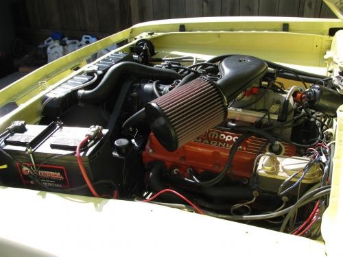

A few cans of hemi orange, a modified beer keg intake, summit headers and dual exhaust(great deal/value by the way), a freshly rebuilt 727 with a shift kit and a 2200 stall torque converter, new driveshaft and a custom stock looking 4 core 22 inch radiator from US Radiator. Schumacher motor mounts allowed me to get the motor in the car on the stock slant 6 k-member.
I kept the EFI, put in 4-hole 24 lbs Ford injectors and bought the Hotrod Wiring harness From HotwireAuto. I used the computer from a 1998 3/4 ton truck with a 5-speed from Solo Electric in Florida and had Sean "HemiFever" send me some tunes and a SCT Tuner.

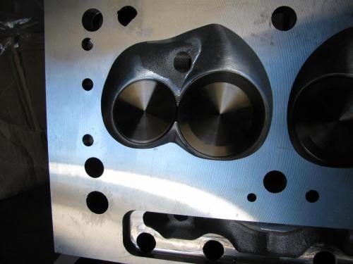

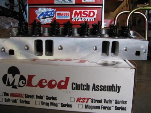

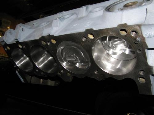

I sourced a nice 5.9 block on ebay and had it delivered for free from Colorado via truck for $300. It was a really nice core. I couldn't find a local motor here to save my life. I ordered up a SCAT cast crank stroker kit with the Keith Black Hypereutectic Pistons, all the engine parts and some CNC Super Prepped Edelbrock heads from Hughes Engines and had them spend some additional time porting blending in the pockets etc, and then had them surface cut to up the compression back up to 10.2 to 1. I also upgraded to a Airgap intake with deep porting, 30 lbs injectors and their Big Gulp throttle body.

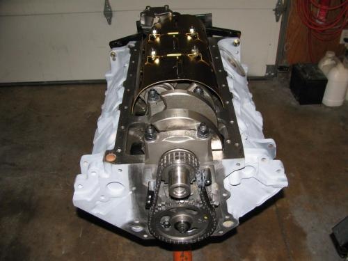

The short block is finally assembled, the cam degreed, and everything but the correct oil pump bolts are installed, I still have a lot of work to do to get it, the automatic overdrive and the Vintage Air A/C upgrade in the car. The overdrive install thread is already started over in the drivetrain section. I'm hoping this will be a minimally invasive torsion bar crossmember surgery installation, but their are lot of skeptics out there. If it is minimally invasive, it will be a different approach than the traditional plate adapter set-up that has been used by many. it should be getting interesting real soon.

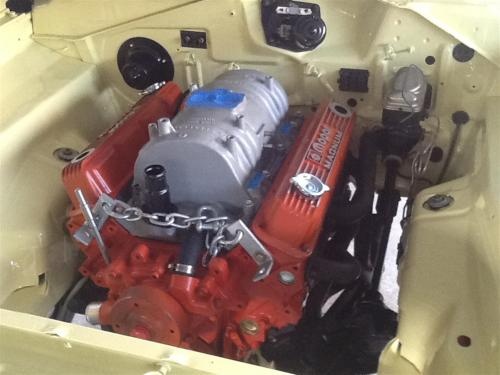

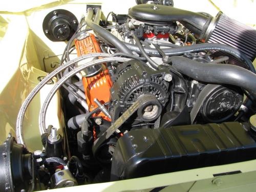

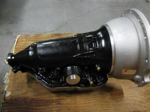

I think my oil consumption problem is that I have a broken ring. I'm going to pull the piston in that cylinder to see if it was just unusual wear or more likely a broken ring. Maybe it's still under warrantee? lol
